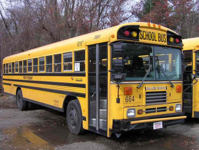

been gone for a couple years (the 4905 went away), now on to a new adventure. I am considering building a 4x4 hauler something on the lines of the picture of the Bluebird that I have attached. (my 4x4 is also a unimog, about 7,000lb)
First, I need better ground clearance for the back country I wander in, and good climbing gears too. Another 4905 will not cut it... of similar monocoque, so a schoolie looks like the direction I am heading. My first thought is a Crown, for the 3 axle and road ranger, but they are hard to find. How about a Bluebird? The frame aft of the axle needs to be sound! Thanks, Peter |

Peter.. our Crown is a 40', 3 axle and the frame stops just a few feet beyond the axle. The "trunk", is behind the fuel tank which is under the rear of the frame, if that helps at all. The trunk was designed to hold all the bags for a fully loaded coach (this one was a highway coach) (42 pax + dirver). Figure 45# per pax and the math shows short of 2,000 pounds for that area. Modifications could change that, but I doubt itcould handle anywhere near 5,000#. I'm not an SE, but common sense tells me it would need some heavy duty changing Interesting hauler you have shown. Best wishes! FWIW RCB (Message edited by chuckllb on February 25, 2009) |

Peter - Wouldn't recommend a three-axle Crown or Gillig - no frame far enough behind the back axle to support the Unimog. Unless you could find one of the (very) rare three-axle pusher models. But then you'd have to get the Mog up and over the engine compartment - which means you may end up with a convertible if you mis-judge a bridge or two. A front-engined Thomas or Blue Bird transit-style skoolie might fit your needs, most have a frame extending all the way to the back. Here's an example:
Another idea might be one of these:
Lots of possibilities out there - think outside the box! FWIW & HTH. . .

RJ: Flat tow is my preferred, but the unimog has straight cut axle reduction gears that would overheat, and also I can't tow a trailer. My original thought was a truck, but I want a flat front to maximize interior room. The frame length appears to be a non-issue, take a look at these clips from the video and you will see that the bed pivots at the rear spring hangers... but I would like to make the bed a foot or two longer so I could get the mog weight a bit farther forward. 14k payload capacity sounds good, distributed correctly!

not my bus, using it as an example of something kind of like what I would like to build. to me it looks like a stock body length bus... the 40' schoolies often have tons of overhang |
