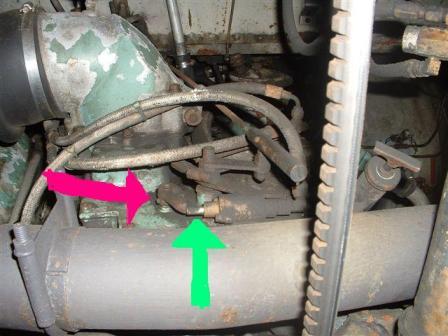

An off shoot from Nellie's thread "No Air Pressure", the use of the emergency stop and having to stop the engine when there is no air pressure to activate the normal engine stopping controls.... with many thanks to the Skiba's for the pictures of a green engine! Reposting from that thread: This is looking in from the rear in an MC8, at the top of the air intake leading from the air cleaner to the top of the blower. The red arrow points to the little handle on the emergency stop device. The handle needs to be pushed down, such that the clip arrangement over at the green arrow engages to hold the flap that is inside the cover stays open. Sometimes, the clip arrangement, which is attached to the electric solenoid that pulls the clip to trip the flap, needs some help by your finger to go into place. This device is intended to let an observant operator try to stop an engine that is running away uncontrollably, due to some failure of the fuel delivery system. It does this by choking off sufficient intake air that the engine either stops or barely chugs along. The purpose being to prevent the engine from running at such uncontrolled high RPM that it damages itself. These failures are due to poor maintenance of that system, re-using parts that should have been discarded, or ignoring the signs of a failing system - sticking, or otherwise uncontrollable moments of engine fueling. A view of the solenoid that is lurking behind the elbow of the air intake:
The red arrow is pointing at the solenoid, note the fresh wire attached to it...preventive maintenance! The green arrow is pointing at the lever and clip that holds the shut-down flap in the open position, between the two views, you can see how it looks...(hard to use pics taken for other reasons!) The solenoid pulls on the levered clip, releasing the round rod, which has a flap connected to it inside the intake, and is spring powered to close. When it rotates, the flap cuts off the engine's air supply. Here is the fuel shut off arm:

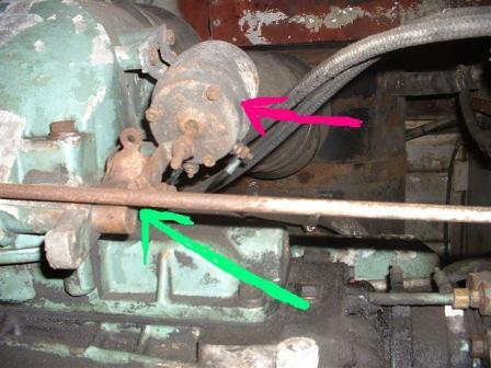

In this shot, the fuel appears to be turned on, plunger retracted. The green arrow is pointing to the air powered plunger that normally shuts the engine off. Without air pressure, or if it is stuck due to little use, either in the on or off position, you may move the arm, which the red arrow points to, with your finger. Take care that you do not put your finger in the way of the plunger! If the plunger moves with your finger in there, it will crush. This is something that should be practiced! With the engine off, turn on the master switch, such that the plunger retracts, and pull on the arm with your finger to see what effort it takes. Take note of the belts, work on your strategy to stay disentangles, loose clothing, hair etc MUST be controlled. Start the engine, and shut it down with your new found skills. You will have to hold the arm until the engine spins down, otherwise, it may pick back up with the return of fuel. happy coaching! buswarrior (Message edited by buswarrior on January 19, 2009) |

Thanks for the info once again. Being a newbie and learning what ever I can, these posts really help. It all makes sense but with out these posts one doesn't think of it. Would shutting the shut off valve down by the filters be just as effective, or would the motor continue to race for a few minutes until it burns the fuel the lines? When shutting the valve down by the filters cause a hard start due to the lines being empty between the filter and motor after that? |

BW super shots they need arcived,I tried to explain to several, most need to get a feel by turning the fuel shut off without the engine running, doing it will not harm a thing. Make sure if you deside to shut running engine down, NO long sleeves IF belt slaps clothing or long hair bad things can happen. Most hair challanged persons need not worry, but those with long hair running belts enjoy. Oh I would not turn off fuel supply valve, cause supply line to pump may collapse,an make for very hard restart. |

One other tip: When manually shutting off the engine, DO NOT allow your finger/thumb to be between the engine stop lever and the engine stop piston. If the piston should happen to come out, you will not be able to remove your finger/thumb and you will be experiencing extreme pain. Jack |
