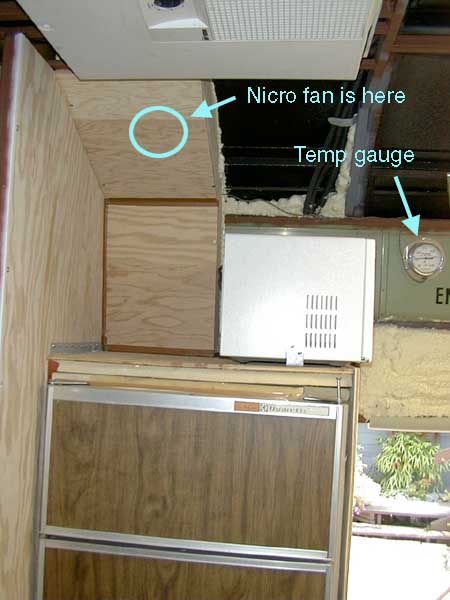

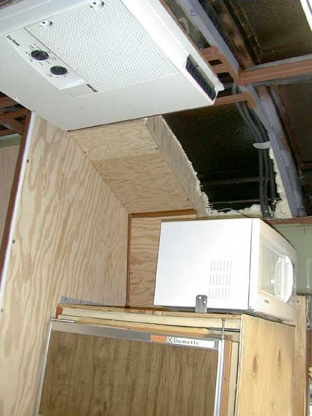

Soooo, I got my old Dometic running fine, everything works as it should, and it gets it's inside temp just where I want it. It's air supply is now plumbed with two 4" holes in the floor, channeled up the back of the fridge (SEALED) to a Nicro Fico 24 hour ventilator. Everything appears to work perfectly day and night. I put a thermometer in the air channel above the fridge just prior to the Nicro, and it reads 110 during the day and about 95 at night. The question, is this about right? Days here are in the 80's right now... Photos: http://www.heartmagic.com/zzNicro.jpg http://www.heartmagic.com/zzFridgetemp2.jpg http://www.heartmagic.com/zzFridgeTemp.jpg] Oh yeah, I also glued sheets of 1" foam insulation on the sides and 2" on the top before I boxed it in. Seems to maintain inside temp where I want it with the control set at "2"... Cheers! Gary |
