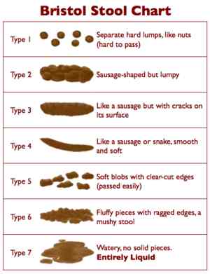

Hey Hojji.... Try adding more fat and oily foods to your diet, and maybe some food stuff that's heavy and stays undigested, like corn... The deposits are just lacking weight and lubrication, I'll bet. From Here: http://www.answers.com/topic/constipation "Sometimes in life, you simply need a bigger stool" (author wishes to remain anonymous) |

Thanks for that post John. I will print copies for everyone I know so we will have something to talk about at dinner. |
Post Number: 690 Registered: 7-2006 Posted From: 72.146.79.42
Rating:  Votes: 1 (Vote!) | | Posted on Sunday, November 30, 2008 - 12:01 am: | |
I have a better copy, suitable for framing, Moe.... $6.75 If you're interested. (this is so exciting!) (I've been a shitty friend, to soooo many people!) Hey Hojji.... How're them turds droppin' ? |
