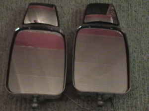

Post Number: 897 Registered: 10-2004 Posted From: 75.203.136.46
Rating: N/A Votes: 0 (Vote!) | | Posted on Sunday, October 19, 2008 - 7:24 pm: | |
These are the Mirrors I'm looking to get. They don't have the amrs but I'm hoping I can find arms similar to what I already have which are only 12 1/2 inches long overall or 10 1/2 inches center to center. If I can get these, they are only 200 bucks for the pair which I feel is pretty good! Any comments? Ace

Yea that's what I thought but then Cliff kind of confused me! I had to go look at some pics of coaches and sure enough they have the Ramco mirrors just like the ones I'm getting! I hope I'm not getting stiffed as I'm buying these sight unseen from a guy on Craigslist. He sort of hounded me to make up my mind and I finally did, sent him the money via PayPal but now I'm getting no response to me emails! I DO have a phone number and an address so maybe he's just busy or out of town! I'll wait and see! Heck it's only 200 bucks so if I get taken, at least it's not 1000's! Ace |
Post Number: 900 Registered: 10-2004 Posted From: 75.203.57.184
Rating: N/A Votes: 0 (Vote!) | | Posted on Monday, October 27, 2008 - 3:46 pm: | |
Hey guys, I received my Ramco mirrors today and they appear to be slightly different than they were described. First of all, they are a little scratched on the back side but nothing I can't live with. It surely doesn't show scratches in the pic was sent. Second, they were described as being SS, NOT CHROME! These are chrome and not SS. They appear to be plastic. None the less, still a good looking mirror and remote too. Now to find some good matching arms! Ace |
