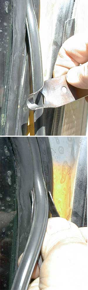

Firecall! I Just got it!! I made a little tool out of stainless spring sheet that I shove in the groove and follow with the rubber... lots of soapy water and it goes in!! http://www.heartmagic.com/zzGotTheWindshield.JPG Thanks anyway!!! Gary |

You can make the tool in 5 minutes for under $3! Easy as 1,2,3. 1- Take a very large cotter pin, like one for a 3/16 hole and 3" long. 2- Enlarge the loop end by spreading the legs open and closing the loop over anything round of the same diameter as the rubber wedge (a 1/4 dowel or drill bit...) will work. 3- screw the legs of the enlarged cotter pin in to a file handle and Walla you own a window tool! |

Thanks guys! I ended up getting both windshields in- took about 10 minutes once I got the tool bent right and the "hang" of it. Yippee, no more cracked glass!! Cheers Gary |
