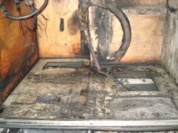

Post Number: 106 Registered: 10-2006 Posted From: 71.239.202.82
Rating: N/A Votes: 0 (Vote!) | | Posted on Saturday, July 12, 2008 - 9:35 am: | |
Here is the floor and the holes under the gen. That small round hole is by the air cleaner. and the rectangular opening in the back is positioned under the head. This is just passive ventilation but that engine running is sucking in huge amounts of air into that compartment from both openings. Additionally the dividing wall is 1 inch short of the back of the door when closed allowing the blower to pull air from there too. So we are discharging some engine noise but believe it is necessary to some degree to prevent failures due to heat as Ed has cautioned about. Over 4000hrs and over 20 years old. (Message edited by Joe Camper on July 12, 2008) |
