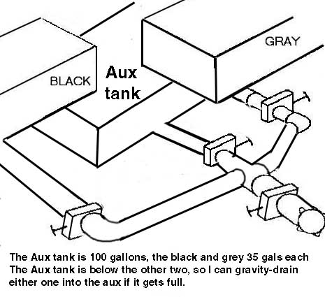

From that cool URL Fast Fred provided ( http://www.phrannie.org/phredex.html ), I got a neat drawing of poo plumbing, and I modified it to what I intend to use on my rig...Besides my black and grey tanks (both 40 gallons each) I've got an additional 85 gallon "transfer" tank and a macerator pump (labelled MP on the photo)- this will let me pump either of my regular holding tanks into the transfer tank if they fill up, or any of the three tanks out a garden hose if I ever have to make a dump out in the boonies... http://www.heartmagic.com/zzPOOplumbing.jpg Any thoughts/ criticisms/ suggestions? (no, I didn't forget the vents, just didn't draw them in...) Gary Stadler |

Beside the fact that macerator pump dump systems take forever to empty a tank I would hate to be the one choosing to "rough it" in the boonies after you had been there. It is against the law to dump in the boonies. At any rate, don't forget to install the standard 3" gravity dump just for the sake of time down the road. |

I agree dumping in the boonies is a baaaaaad thing to do. Dire emergency only, if even that. For the most part the system is set up this way so I can use the 85 gallon tank as my emergency place to dump!! And if you look at the drawing, yes, the gravity dump is there, lowest thing on the drawing. Thanks for the comment! Gary Stadler |

I have a very good reason to use the pump... the place where my bathroom is can't house a tank below any larger than 40 gallons. I sometimes stay in one location for up to two weeks with myself, my wife, and two guests. This kills off a 40 gallon tank rather quickly. I have a space for the 85 gallon tank in a different place away from the pooper, so this is why I've come up with the pump thing... Hmmm, one tank for both... I guess there's no real reason why not, except cleaning the stinky slinky might be harder without a load of grey to wash down it after the black has gone thru... Cheers Gary Stadler |

The most common place to need a waste pump is visiting friends. If the outside waste clean out at the home can be found , dumping is a snap. Much nicer than having the waster hose go in thru the window of the bathroom & using the toilet. Although the Mfg of toilet pumps tell you they will lift some , they dont tell you they burn out doing it. The waste pump should ALWAYS be gravity feed , 120V if you have an inverter or fed with FAT #10 wires on 12V , they also drink more amps than the Mfg. claims, and burn out on low voltage. There are newer brands that "should" need less frequent repair , but their falure is a messy happening. FAST FRED |

I use my macerator pump most of the time. I usually dump at home and pump to a sanitary sewer line. It is also handy when we have RV visitors, It is a little slower than a 3" hose dump but not enough to overshadow the benefit of dumping at home. I do not use the pump at a regular dump station, but I have used it on the road to reach a stool or drain that I could not use otherwise. With both systems you have a "plan B". I use small battery clamps to connect to my start batteries (right next to the water bay). Very quick and convenient. I use a 3 conductor, 12 gauge extension (very plainly marked 12v only) if needed, to reach the battery on a guest rig. Couldn't dump at home without it. Jim Stacy |
