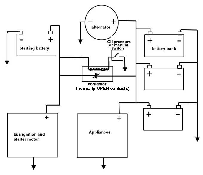

Rating: N/A Votes: 0 (Vote!) | | Posted on Wednesday, May 22, 2002 - 6:36 pm: | |
The best I could find was Stancor D.C. contactors from Newark Electronics (www.newark.com) part number 44F3645 (12v) or 44F3648 (24v) These are about$50 bucks each, single pole normally opened, and rated at 200 amps continuous, 600 amp surge. The coils are set up for continuous duty. I'd guess they would be quite sufficient... Gary Stadler |

Hi Wayne, Either way will work, isolators or solenoid relays, although the problem you've run into is that your alternatior is big enough that it's capable of poofing a lot of isolators. Personally I like the solenoid approach more, because isolators are basically a solid state diode and have an associated voltage drop...to install one properly you'd "technically" have to turn the regulator up half a volt at the alternator to make up for the isolator's drop (which is not a "user-doable thing) but because you can't, the batteries never get the full 14.7 volts they want for a full charge. Plus the isolators easily availiable are not rated for 300 amps as you've found. With the solenoid I suggested, the 300 amps is not a problem, because they can handle 200 amps continuously and 600 amps on a surge. When you start charging drained battery banks, it's very unlikely that high currents will last more than a few seconds...batteries tend to take a lot of current for a small amount of time, and then settle down to a much lesser charging current for a long time. The 200 amp solenoid would easily handle this- that's how it's rated.... plus the fact that you'd be charging two banks of batteries, the bigger of which wouldn't even be going thru the solenoid. The idea then, is to hook up the solenoid so that once the engine is running, it is turned "on" sending charge to the starting battery. When the engine is "off" the solenoid disconnects the alternator and bus "appliance" system from the main starting battery and ignition circuits, so there is never a load on the starting battery until you turn the key to start the vehicle. The best way to control the solenoid would be to figure out a way to kick it in automatically once the engine is actually spinning (a pressure actuated switch on the oil line would be a perfect way)...this would be better than doing it manually, because you take the "oops I forgot" out of the equation.... So the scenerio is this... the alternator is permanently wired to the big bank of batteries that you will run your appliances from when not driving. This is the bank that will take the massive charge rate anyway, so the solenoid isn't even concerned with this part of the circuit. When you start the engine, the manual or oil-pressure operated switch turns the solenoid on, enabling your "starting" battery to charge. This battery would NEVER take a full 300 amps, so there's not a problem with the 200 amp solenoid at all.... Hmmmm, after thinking it out for you, I think this is exactly the way I'm going to do mine!!! Here's the schematic.... http://www.heartmagic.com/zzbatteries.jpg Regards Gary Stadler |

Gary, the schematic looks great except that the contacts of the contactor are shown normally closed. I believe they should be open, until the oil pressure switch closes, which in turn will close the contactor contacts. Richard |
Rating: N/A Votes: 0 (Vote!) | | Posted on Wednesday, May 22, 2002 - 10:49 pm: | |
Correct, they should be normally opened I'll note that on the drawing... Gary |

Gary, Thanks you're solved my problem for me. The light finally came on in my old brain. I've ordered the contactor and will install it according to your schematic. Thanks to all for the input, it helped me alot. Wayne |

Gary, My system has been working for several years just as you have drawn it. I did add a "pick" circuit to the solenoid from a small plug-in relay operated by 120VAC (not on the inverter circuits). Then when AC is present (as with a land line or gen set running) the 120VAC relay operates and energizes the main solenoid so the Inverter/ Charger can charge both banks. Works great, no heat, no voltage drop, no action required - completely passive. FWIW Jim Stacy |

Rating: N/A Votes: 0 (Vote!) | | Posted on Friday, May 24, 2002 - 1:20 am: | |
Great idea Jim! I don't have to do that on my rig because my battery charger has four diode-isolated outputs and it could charge 4 separate banks if I wanted it to. But not having that, your design is a great idea!! Gary |
