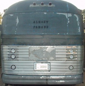

The back of my bus has always bothered me. it had been "butchered" to install lighting that was not in keeping with the look of these old buses. I know that when it was done they had a reason to do it. Well, I finally did something about it. Being on a budget I fabricated "patch panels" to cover up the rectangle hole that was cut to fit the lights rather then buy new complete panels at nearly $700. I then cut new holes in the patch panels to fit new LED lights. And also installed back-up lights in the original lower panel holes. I also cleaned up/replaced the wiring on the inside. Because my bus is still positive ground I had to install relays to activate the lights. Here are before and after photos.
I also stripped off the paint. Here is a close up of the "fix" The ribs in the aluminum patch panel were difficult to match. They are a little off. . (Message edited by zimtok on October 30, 2007) |

Very nice job. How did you make the ribs? |

Well done! I too would like to know how you made the ribs. Blessings, David |

Nice job, like Laryn I'd like to know how the ribs were made. Ed |

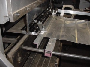

I have a small hand operated brake/shear (Harbor Freight) that I made a rounded die for and an adjustable guide. The first rib is used to locate the next rib and so on. the sheet of aluminum shown in the photo is my test sheet. (very thin) the sheet I finally used was a thicker sheet (22 ga) still thinner then the aluminum on the bus but strong enough to hold the lights.

Very clever tooling. Since I don't have a brake that large I have decided that I can make the ribs for my 4104 with two pieces of padded angle iron and my hyd press. It all depends on what tools one has I guess. |

Gus, You are correct... I've always had to make do with the tools at hand. Most of the home made tools and jigs i made over the years did their intended job. (some failed badly) I'm to a point now that I have some tools that make things a little easier. I still want a few more tools (it never ends) Jim-Bob, Thanks, I'm really trying to clean her up and bring her back to something close to her original beauty. . (Message edited by zimtok on October 30, 2007) |
