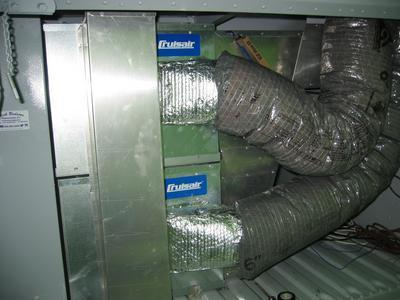

 Hi Bill, You asked for some..... Nick- |

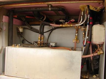

Rating: N/A Votes: 0 (Vote!) | | Posted on Thursday, June 21, 2007 - 6:47 pm: | |
And the other side of the tank compartment |

Thanks for the pictures Nick!!! Can you describe what i,m looking at here? It looks to me that you have a tank gauge. I take it that the smaller tank is your fresh water tank. How big is your tanks??? How do the cruise are work??? What can I use for my drivers air without running the genset? I do not have bus ac anymore. Sorry for so many ???s but I need the knowledge!!! -- BILL |
Post Number: 126 Registered: 2-2006 Posted From: 75.197.252.150
Rating: N/A Votes: 0 (Vote!) | | Posted on Thursday, June 21, 2007 - 9:52 pm: | |
Hi Bill, The two big tanks are Fresh water and gray water at 105gal each. The smaller tank is black at 50 gal. The tank sensors are Sensa Tank RV 100 tank monitoring system by MSC engineering that also sences LP but I don't use LP. Both gray and black tanks are Y-ed together with seperate dump valves. My Cruiseair's are selfcontained heat pumps at 15,000btu's each and are more then enough on the hottest days. I don't run them down the road. I use OTR coach air. What I discribed to you in your other thread about installing a car type compressor hooked to your dash evap is the second best way. Third, would be to mount a roof air directly over the drivers area and pipe it to blow on you. But thats about all you will cool is you. Unless you want your wife to sweat.LOL Good Luck Nick- |

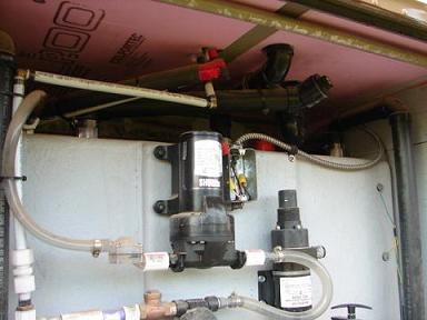

Hey Bill here some pic's of my water/septic bay |
Ron Walker (Prevost82)
Registered Member Username: Prevost82
Post Number: 315 Registered: 11-2003 Posted From: 208.181.210.47
Rating: N/A Votes: 0 (Vote!) | | Posted on Thursday, June 21, 2007 - 10:39 pm: | |

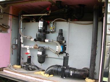

Try this again
This is the curb side of the water/septic bay. Hydro-Hot is in front of the tank. Toilet pipe is in the middle left of the picture. (Message edited by prevost82 on June 21, 2007) |
Post Number: 316 Registered: 11-2003 Posted From: 208.181.210.47
Rating: N/A Votes: 0 (Vote!) | | Posted on Thursday, June 21, 2007 - 10:53 pm: | |

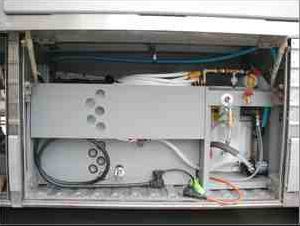

One more ... above is water/septic bay on curb side with Hydro Hot in front. Septic is on the left on water is on the right.
 This is Driver side water / septic bay ... water is on the left septic on the right. I had a custom made tank ... they glue the plastic sheet together and welded in the baffles then fiberglas each tank then put the 2 tanks together and reapplied more fiberglass, they also fiberglass a piece of 3/4 plywood on this end (shown above pic)to mount pumps etc on. The 2 black pipes (on each side) coming from the ceiling and through the floor are the vents, on the post before this one you can see another black pipe also that is another septic vent, one on each side of the bus. Hope this helps Ron |

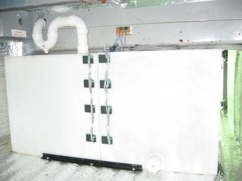

Rube checking in. ;)
Two 100 gal horizontal tanks - fresh on top, grey on bottom. I probably would not do that again. I thought the horizontally-oriented would distribute weight better, which is true, but slow to drain when less than 1/2 full. Door removed in front of piping so that JohnMC9 can peek. ;) |
Post Number: 398 Registered: 7-2006 Posted From: 66.217.107.34
Rating: N/A Votes: 0 (Vote!) | | Posted on Friday, June 22, 2007 - 12:05 pm: | |
Real neat, Chuck!! Nice job indeed! Maybe better with the waste tank on the top? It's an easy fix, tho.... just swap the connections!! |
