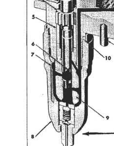

seals your not talking about the seals that are on the injector tubes . Im missing something here . Inline 71 right , injector is held in with a crab then two jumper lines right ? Send picture |
Austin Davis (Zimtok)
Post Number: 90 Registered: 9-2006 Posted From: 216.37.73.226
Rating: N/A Votes: 0 (Vote!) | | Posted on Monday, February 12, 2007 - 5:11 pm: | |
There is no seal between the injector and head, but there is a seal on the injector between the body and nut. Item #10 in the drawing is the seal.

It is definitely the seals. I have looked at this very closely and there is NO fuel leaking from the lines or upper portion of the injectors. It comes from around the base of the injector body. I believe it is a 4 valve head. (I've been concentrating on the leak and not much else) . |

It happens every once in a while that the seals in the injector body will leak, especially if the injectors have been in the engine for a long time and then are disturbed for some reason. The best solution and the safest is to replace all the injectors with rebuilts.The other 3 injectors have been in there for probably the same amount of time, and most likely will start to leak shortly after you have replaced the 3 that are leaking now. As to the color of the tag, is it perhaps brown? A lot of 71's had brown tag 65's installed on overhaul when the engine was moved to advance timing. I notice somewhere somebody said the fuel were torqued to 12 to 15 foot pounds!!!! NO NO it is 12 to 15 INCH POUNDS! guy 4905 (Message edited by Guy_Bouchard on February 14, 2007) |

I agree...if it's leaking where you say...that's a non serviceable seal,replace injectors.. |
