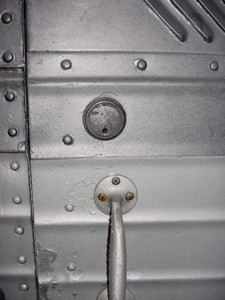

I went kinda backward. There's no room in my door (British double-decker bus) so I put the lock in the bus wall so that the deadbolt pin goes into the door. Works ... that's my way. |

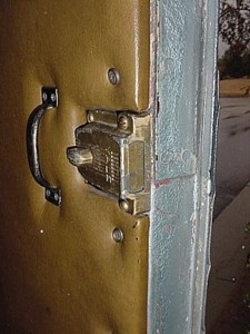

My bus has a simple "old style" deadbolt.

Airstream has been using the wall mounted deadbolt for many years. It has a lot of advantages over the door mounted unit. It is much easier to make it strong, the deadbolt is not protruding into the walkspace, etc. Even tne travel trailer folks have some good ideas. |
