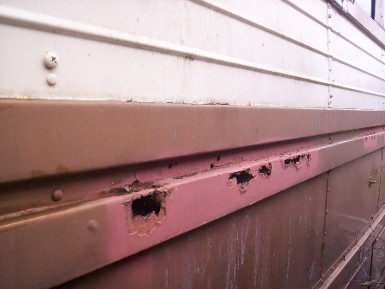

Well if this works here is a picture of the rust in one spot. I believe this is the worst area. between this belt line and the windows, the white area, is steel on this bus but below it is aluminum
the rust was caused by someone filling in the area under the windows with spray foam and sealing off the drains. I am taking all the sprayfoam out so I can redo it properly and put in the drip pans to direct the water down the drain area. I dont know about other busses but this one had schoolbus windows and they drain out right at the bottom of that belt line. I know about the electrolosis thing I build aluminum boats for a living. (Message edited by greentowtruck on November 14, 2006) (Message edited by greentowtruck on November 14, 2006) |
