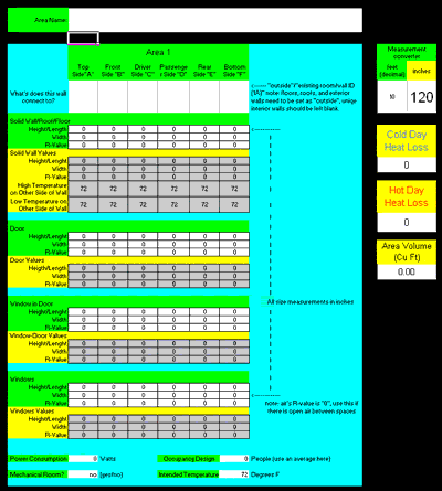

A while ago I created an MS Excel spreadsheet for heat loss (or negative loss) for 'yall. A fellow BusNut Jim Behr was nice enough to host the zip file on his webpage. Looks like the link to file is still okay: HeatCalc V2 I tuned it for busses but it could be used for other structures. It accounts for inter-"zone" temperatures and internal occupacy and power consumption.
It's really eye opening how quickly a large single pane window will dump heat outside your rig . Cheers! -Tim |
