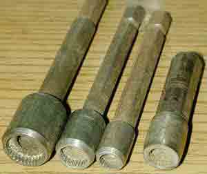

RC, are you trying to remove Gulmite screws? (those nasty little things with round, serrated heads) If so, just get (or make) the correct tool for the damned things and they'll come out mucho easy. Otherwise there is no easy way to remove them as you've found. They are hard as rocks, slippery as snail goo and stuck well. Let me know if you need to find the tools....
Otherwise about the only option that works is to Mig (or preferably Tig) weld a hunk of steel to the top of them and unscrew em that way. Takes some good welding talent but it works.... Gary (Message edited by boogiethecat on May 02, 2006) (Message edited by boogiethecat on May 02, 2006) |
