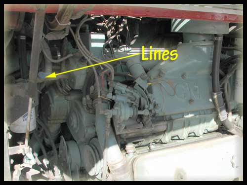

Hey Folks: Driving our new Buff on it's first outing went smooth as silk, but during last few hours on the way home (about 2,000 miles into the trip) the trans. temp starting running too high (over 230 deg. F). I checked the fluid thereafter and it was fine, midway up the hot zone. The time it took to pull over and check the temp. cooled the tranny down considerably. From other posts, I understand that this tranny can get hot running locked-up for long highway stretches (not enough air flow, road heat, etc.). My particular installation (V730 was not stock on my bus) DOES NOT have the giant engine coolant/ tranny oil cooler that my Fishbowl had. I wondering if this is a gross oversight and I should track one down and plumb it in. My bus DOES have an air cooler for the tranny oil, but it's stuck up behind the engine bulkhead in that empty space between the bulkhead and the rear axle (old washroom tank, maybe). No free air can seem to get to it. I also suspect that the temp-controlled fan on the cooler might not be working. But I'm planning a trip to SF and through the Sierras in two weeks and would like to make cooling adjustments NOW, rather than on-the-road. You can see a photo and some notes here: http://www.brownland.org/bus/4108/v730.htm I'm open to moving the air cooler, adding an engine coolant cooler, cutting a cooling hole in the tranny door... whatever. Thanks! Brian Brown Longmont, CO PD4106-1175 P8M-4108A-216 |

Thanks, Sammy. The pages would be awesome to have. You can get my email address by clicking on my name. An RTS boneyard/ parts source shouldn't be too much trouble to find. There would be plenty of room on the cradle rail to install one. I could set a valve on the coolant side for the times I don't... probably. In fact, my coolant filter already has valves on it. I wonder if these lines are sufficient.
Thanks! bb |
Sammy (Sammy)
Rating: N/A Votes: 0 (Vote!) | | Posted on Thursday, April 27, 2006 - 9:09 pm: | |
Brian, those lines will be too small. Check your e-mail, sent info for you. Hope it will help you. Sammy |
