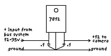

JW, if you wanted to use that 3 light sequencer, I'd be willing to bet it draws much less than an amp, in which case you could use a very simple linear regulator to drop your 24 volts down to 12. (This assumes also that you'd replace the lightbulbs with LEDs which draw much less than an amp) It'd be a 7812 part, avaliable from even radio shack, a tiny heatsink and two .1mfd capacitors. Since the mounting tab of the regulator is the ground connection for it as well as the middle pin, bolting it directly to almost any metal surface on your bus would easily suffice for the heatsink in this application... There's a circuit in the archives, here again for your reference (I drew it for bus cameras but it would work for this just fine): http://www.heartmagic.com/7812.jpg |

That'd probably be easier than what I was contemplating. I guess I should ask the other question. I was a bit surprised when I drove my RTS home, and found out where the signals are. It has two signal buttons on the floor, that I have to stand on. While it seemed like a good idea to leave the driver hands free to steer, it was distracting for me to keep pressure on the signal button while wanting to signal. I didn't notice if the MCI's are like this or not. Does anyone have suggestions on converting this to something a bit more conventional. My immediate thought was to put a DPDT switch on the dash somewhere. Being that I was going to bother do that, I didn't think it would be that much more work to switch it over to 12v, but really I should know better. |
