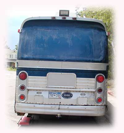

My 4104 has some corrosion in some of the body panels. Some are so bad that they need replaced but others only have a couple spots. What I was wondering is if their is a way to fix it and still be able to buff the panels out to crome. My other question is how to prevent it in the future. |

Buffing an anodized aluminum out to "chrome" will look awfully pretty for a short while, then just awful unless you have nothing better to do with your time and $ than to continuously polish. Best (practical)way to prevent corrosion in the future is probably to paint. |

I realy would like a crome finish on my bus, but I would like it to last longer than a "short time" what about if I buffed it out then used a cleat coat over the hole thing to protect it from the elements would that work... has anyone tryed it. let me know I think a big silver bus would be fairly nice. thanks for any help |

Want shiny skins? then replace with SS from IBP, Talk to Rich or visit Arcadia and see a 45' Stretched Seniccruizer in SS! This issue has been up on the BB's before. IIRC, I don't think the clear coat lasts long enough. It yellows and takes away much of the "shine" you value. Go with Stainless Steel if this is the only bus in the world for you and it has to be "chrome" |
