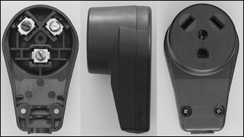

I bought a 30' 50A power hose brand new which has the male end but stripped wires on the other end which would normally go to the main disconnect on an RV. I hoped to make an extension cord and put a female receptacle on the end but have been to two different elec supply houses and they say no dice. I'd rather not do a clunky wallbox homemade look, but will if that's all I can do. I lost patience with the Grainger site - do you know of a resource for a female end like the one in this photo?

If you're looking for a molded on receptacle like the one pictured, you won't find it. However, if you go to Home Depot, you'll find that a 4 prong range plug matches up, but that's probably the surface mount receptacle that you don't want. Ross |

Thanks, Ross. I know it won't be molded, but was wanting something more 'cord-friendly' than a surface mount. You know, like a replacement receptacle for an extension cord except 50A. Like the plugs one can get, but female instead. |

Chuck, AFAIK, it doesn't exist, because there is no market for it. The handful of manufacturers that make 50A extension cords, dogbones, and pigtails for RVs use molded-on connectors such as the one pictured. Most everyone who is making detachable shore cords uses a twist-to-lock style female on the coach end of the cord (and these are readily available). In the fixed-construction market, nothing using this style of plug is permited on an extension cord. So about the best you can do is the all-in-one, surface-mount style receptacle. That will be a bit more compact (and stylish?) than building one out of metal box and other parts. That being said, if you make it yourself, you will be able to use outdoor-rated parts, at least for the box, cover, and cord entry. The surface-mount units are definitely not outdoor construction. Good luck! -Sean |

Chuck- Go to any RV shop and buy a 50 amp female connector. (I did) http://www.campingworld.com/search/index.cfm?action=search&tcode=11&keywords=50+amp+socket http://www.nooutage.com/rjbc6364.htm I'd post all the URLs, but it'd fill the entire bbs. |

Thanks anyway guys - the surface mount from Homely Depart it will be - changing to a Marinco-style twistlock defeats the porpose, and cutting one off a dogbone would be far from the 'stylish' solution Sean knows I'm looking for. The little photo on this page shows what should be it, but the detail photo isn't correct. I'll call them tomorrow.

Hey Chuck... I did not think to look at the Camco stuff. That's a brand new product, only been out a few months, IIRC. I thought they were molded on, but the photos seem to show what could be a clam-shell type attachment. If it is, it might be worthwhile for you to buy their dogbone and scavenge the connectors from it. When you find out, please let us know if these are really assembled units, or molded in place. I'd like to know for future reference. -Sean |

Chuck: They don't make a 50 amp cap that you are looking for, you will have to use a 50 amp RV receptacle that you can get at any RV store. They are about 16 bucks without the cover and box. You can't use a range receptacle cause the ground post is D shaped instead of round for RVs. Bill ragingbull@wcoil.com PS Just went out of the RV business, can't find one I've got 3 left, they don't make a weather proof cover for them either. |

Bill, 30 amp RV outlets are specific to RVs only. 50 amp "RV" outlets are identical to the 50-amp range outlet you can buy in Home Depot. The issue of whether any given plug has a round or D-shaped ground tang is irrelevant, as they will both fith the D-shaped hole in the receptacle. AFAIK, there is no reason why RV manufacturers need to use one type of tang over the other, and the same goes for range manufacturers. -Sean |
