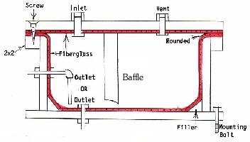

Locating the openings for the fill, the drain, and the vent is part of the designing process. With either technique, the holes are cut before the tank is assembled or fiberglassed, but the fittings are not installed until just before final assembly (putting the lid on). ABS, PVC, or CPVC fittings are used to make the connections. A fitting is cemented onto a short piece of pipe placed through a hole in the tank. Another fitting is placed on the pipe where it comes out so that both fittings are tight against the tank and cemented to the pipe. Epoxy putty is used to bond/seal the fittings to the fiberglass.
Baffles in the tank are needed to prevent damaging waves from forming when the coach stops abruptly. I made these from half-cylinders cut from plastic drain pipe. They were bonded to the under side of the lid and went down near the bottom, but enough room was left so that waste could flow out unobstructed.

here are many tanks available for both water and sewage. Unfortunately, finding one that gets the maximum storage in the space and shape available in your coach may be difficult. About the only way to get a tank that just fits is to make it yourself. The tanks I built use fiberglass on plywood techniques. The plywood is for structural strength and shape and the fiberglass is for waterproofing and additional strength.
There are two basic ways to make a tank using the fiberglass on plywood technique. The first is to make the tank out of plywood, assembling the bottom and sides and then fiberglassing the inside and the inside of the lid. With this method, a flange can be left around the tank to secure the tank to the coach. You can also make the lid removable. The second method is to cut the plywood pieces and fiberglass each one first. The tank is then assembled using an epoxy cement and a few layers of fiberglass over each edge to hold the joints together. This technique is
easier, but a mounting flange and a removable top are not practical. A lot more work is needed with the assemble-first technique to get both the inside and the outside corners rounded so the fiberglass will lay properly. It is also much more difficult to lay the fiberglass on the vertical sides.
