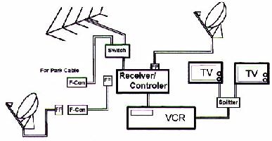

To watch satellite TV, you need some electronics and the codes to
descramble the signals. The electronics (earth station) consists of a dish reflector that directs the energy into a feed horn containing a low noise block amplifier (LNB). This makes up the antenna system that connects by a cable to the receiver/controller. The receiver/controller is about the size of a VCR and is usually located near the VCR. Its function is to descramble the signal and convert it to one the TV can display. You must pay a programming provider to get the code to descramble their signal. Satellite dishes can be mounted permanently on the roof, but most people just use the dish that comes with the system and build a base to hold it.
In normal home operation, the receiver/controller is connected to
the dish and the telephone lines. It communicates to the programming provider via the phone lines. The programming provider communicates with the receiver/controller via the satellite link. This generally happens during the middle of the night. If your system is not fully operating, you will not get the new code. You can call them and arrange for a retransmittal, but the dish must be up and the system operating in the standby mode when they download.
