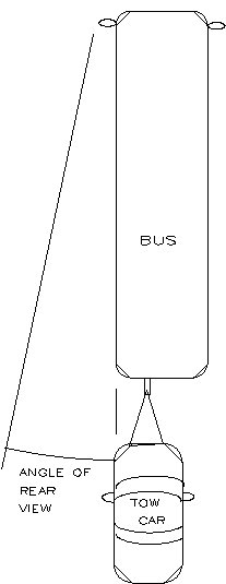

His tow hitch was offset to the drivers side of the bus by about a foot and half. "What’s this all about?" I remarked. Well, Bob kinda grinned and began to explain.
This GMC 4905 is a forty foot, two axle bus and it’s turning radius is kind of big. In fact, when Bob brought his bus into my back yard, he had to back and fill many more times than I do. Bob went on to explain he had two major reasons for the offset tow hitch.
First, with the offset tow hitch, he could look in his rear view mirrors and see his tow car’s left mirror at all times. A lot of us have rear view television monitors to keep track of our tow vehicle. And, a lot of us just rely on looking for the tow car shadow to reassure us of it’s presence. But, with the offset tow hitch, Bob has a piece of his tow car in sight at all times.
Secondly, when the tow hitch was center mounted, Bob had a tendency, when making a sharp right hand turn at a corner, to bounce the wheels of the tow car over the corner curb. Now, with his offset tow hitch, he misses the corner curb with both the bus and the tow car. Now you may ask, why doesn’t he bounce the tow car over the curb on a left hand turn? Duh.

Some may inquire as the eccentric loading on the towing vehicle. This is not really important since it can be accommodated by some simple structure. After all, the Eagle model "oh-five", and on have the motor offset by seven inches. Do you think an eccentricity of 18 inches on a 35,000 pound bus towing a 4,000 pound car will matter that much? In my experience, the bus considers the tow car to be nothing more than a slight annoyance. I feel confident that bus could allow the tow car to be pulled tangentially with nothing more than a slight correction for steering. It may be argued that a certain amount of right rudder has to be held while towing the car in an offset fashion. And, this will ultimately wear our your steering system along with the associated tires. According to Bob, he has less pull than driving in a light cross wind. In any event, I classify this concept as a truly unique idea and Bob Jones is to be congratulated.
